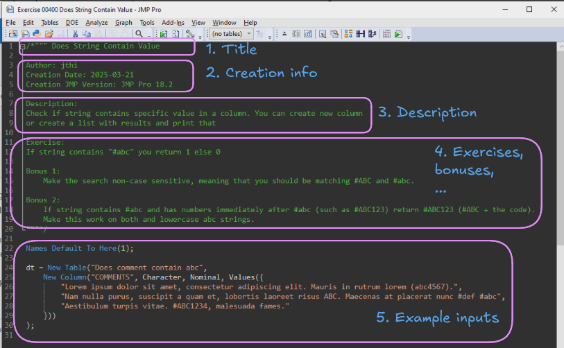

Here is the first set of exercises and challenges and some suggested solutions to them. I have created and modified these for you to improve and practice your JSL, problem-solving, algorithm development and general programming skills.
As there are so many files, I have uploaded them as two separate .zip-files, one for exercises and one for solutions. Let me know if they are for some reason too difficult to access as .zip-files and I can for example add them to github repository (that is something I might do for set 2 as it will be much easier to update them if there are any mistakes).
The exercises (mostly) follow similar pattern in the .jsl file:
  1. Title of the exercise
  2. Some creation information (author, when it was created and which JMP version was used)
  3. Short description of the exercise or for the case
  4. Explanation of the exercises and examples what should be returned.
  5. Example inputs, nothing prevents you from creating your own inputs and I even suggest you do after you understand the exercise properly
