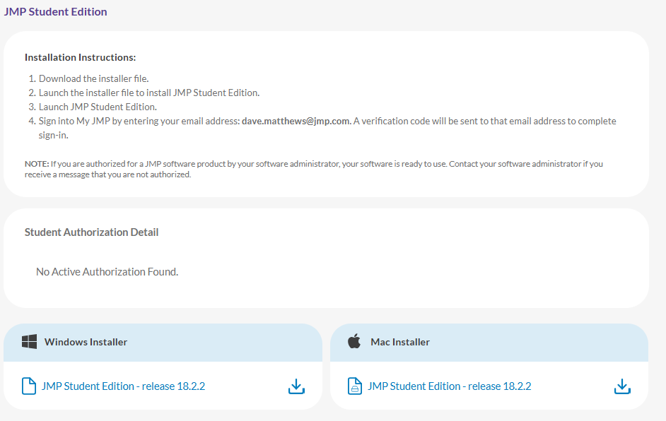

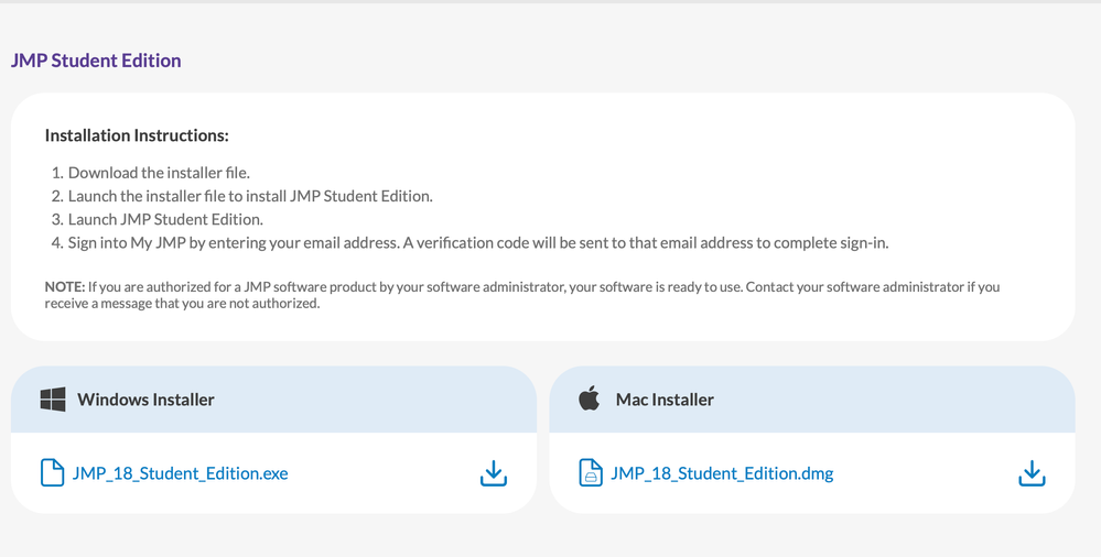

To download the JMP Student Edition installer,
  1. Verify your eligibility via your institution to access the installer.
  2. After completing the steps proceed with downloading the JMP Student Edition installer.
  3. Sign in to My JMP.
  4. Click the download icon for the software to download
  5. Below the installation instructions, click the download icon for the desired operating system.
How to deploy JMP Student Edition into a university computer lab or computer classroom?
Follow the install instructions shown in how to download the JMP Student Edition installer.  The software will need to be installed using administrator privileges.  Simply, repeat the installation steps for each lab or classroom computer required.  Alternatively, after the software has been installed a clone or disk image may be created.
