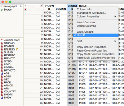

The demographics table (demographic.jmp) contains a unique row for each subject.  Therefore, USUBJID column in this table will be the “Link ID” column. The Link ID column property marks a column in the auxiliary data table as the ID column. That is, the rows of the data table are uniquely identified by the values of the ID column. There are several ways to assign this column property, but you can simply right-click on the column and select it, which places a check mark beside Link ID, as shown below.LinkID.png

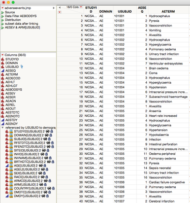

Once that Link ID is set in this table, you can reference it from the adverse events table (adverseevents.jmp) with the same identifier column (USUBJID). To assign your “Link Reference” column property, use the right-click method again on that column to easily select the demographic.jmp table that you want to reference or link back to, as shown below.
linkref
When the Link ID and the Link Reference are set up properly in both tables, you will see a gold key in one table and a blue key in the other.
From demographic.jmp:
From adverseevents.jmp:
Below you can see the adverseevents.jmp table, with the referencing columns from the demographic.jmp table in the columns panel:RefColumnsLinked.png

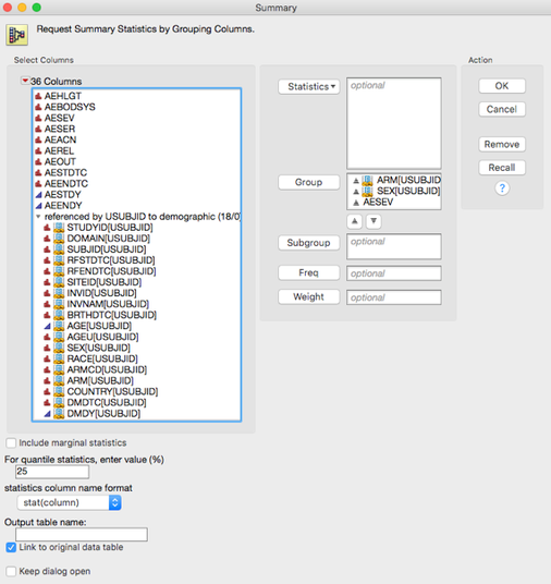

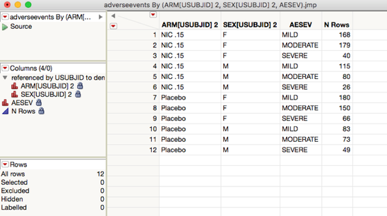

It is also nice to use the Summary platform to find the sum of how many subjects used the Placebo vs. the NIC . 15 grouped by ARM[USUBJID], SEX[USUBJID] and AESEV, and see that the majority of the cases reported mild severity in adverse events. Using Tables - > Summary you can select the following and then see the table produced below.summary.png
