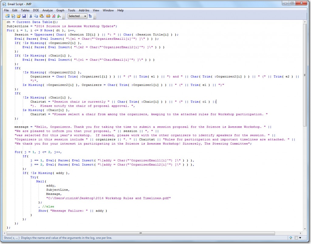

Faced with a rather well-defined structure, the JSL script cycles through each line in the data table to build and customize email text, attach a PDF file of important timelines and send the message (Figure 2). The Mail function is placed within a Try so that if the message fails to send for any reason (such as an incorrectly defined email address), a note is written to the JMP log. You may notice the j-indexed loop towards the bottom. Currently, Mail supports sending to a single recipient, so it is necessary to loop through the number of organizers (up to two in this case). This is the reason for including all organizers in the body of the email. However, if a proposal had only a single organizer, the below script would work (as it does for entry #2).
Figure 2. Script to Respond Positively for the Science is Awesome Workshop
