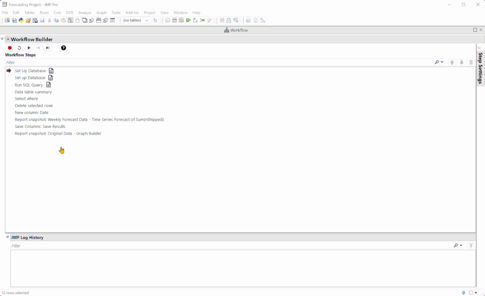

Note: This entire process needs to be automated, so begin by going to File > New > Workflow, then select the Record button to implement all of the necessary automation. If you're unfamiliar with the Workflow Builder, check out either this quick introduction or this more detailed explanation.

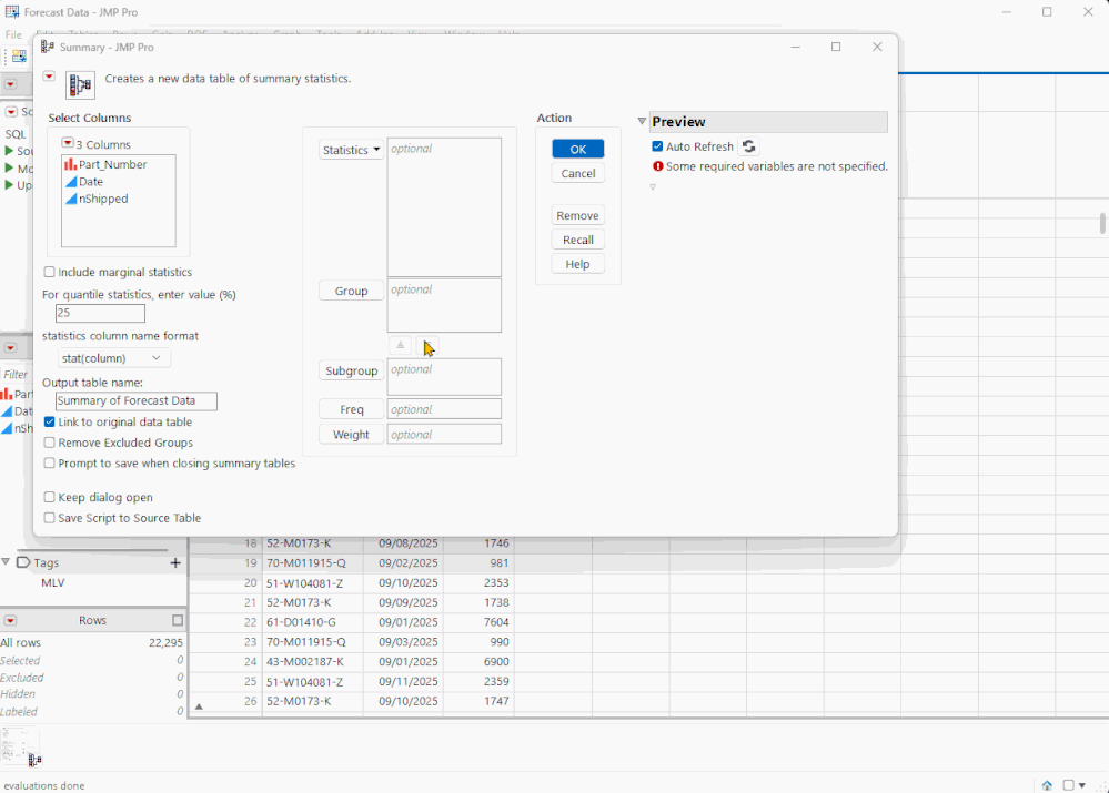

The Tables > Summary tool is a convenient way to shape the data into a weekly format. Creating both Week and Year columns will be useful later, especially if the forecasts being made span different years.

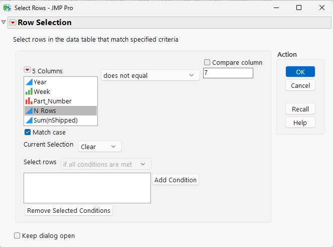

Using Rows > Row Selection > Select Where and selecting all the rows that don't have seven data points makes it easy (and repeatable for the Workflow Builder) to keep only complete weeks. Delete the selected rows after clicking OK.

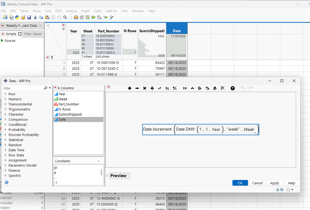

One more data task is necessary before creating the forecasts. Create a new column with a formula for the date, based on the year and the week. This is useful because it forces all the data points to be in consistent weekly increments, which is important for forecasting tools.

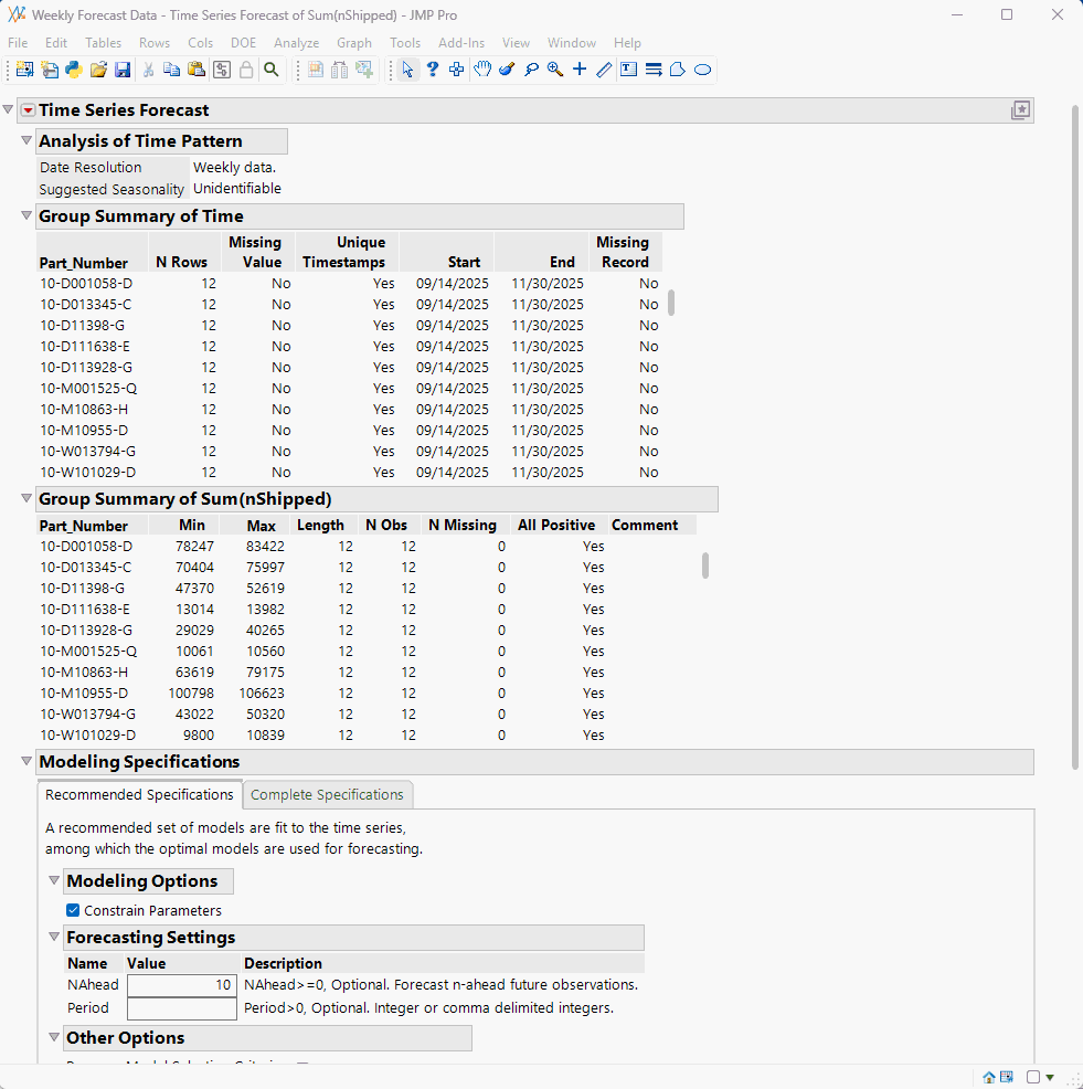

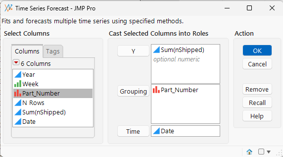

Now that the data is cleaned and structured properly, Time Series Forecasting in JMP is the easiest part. From Analyze > Specialized Modeling > Time Series Forecast, it’s very straightforward to populate the three fields:
In the window that appears after selecting OK, the platform presents summaries to help you ensure that the data is consistent. After reviewing the summaries, set the number of future time periods you’d like to forecast. Click Run to see the forecasts for all ~250 SKUs.
Note that each SKU has been given an individualized forecasting model specific to the historic data shape for that SKU. More information on the types of models can be found here.

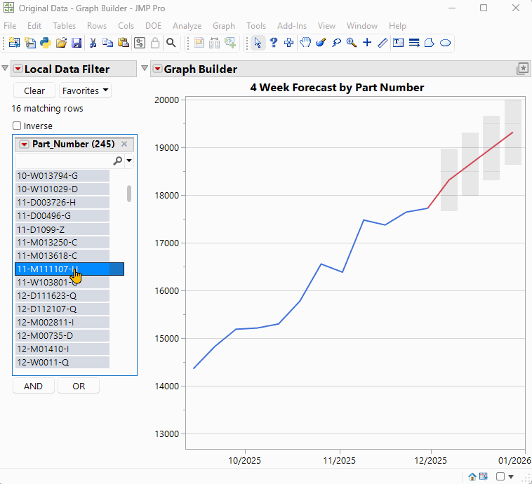

Since many people who will use these forecasts aren't particularly interested in the statistics involved, changing the format of the predictions into a simple interactive graph can be helpful. Use the red triangle option to select Save Results, which creates a new data table that includes the forecasts and other data; it can also be used with Graph Builder to create a simple lookup tool.

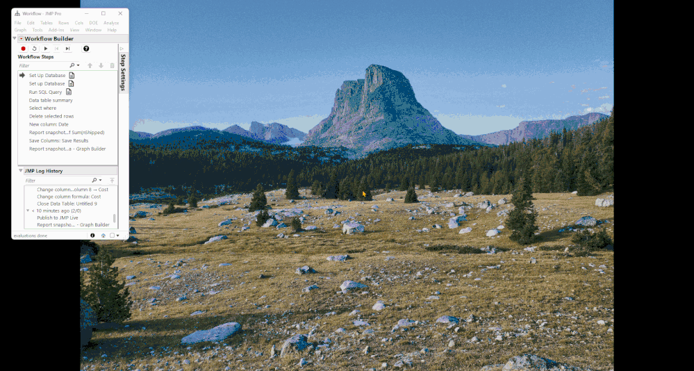

Earlier, I mentioned using Workflow Builder to record the process. Since all the steps were recorded, they only need to be done manually the first time. Whenever the forecast needs to be updated, you only need to click Play, which means that RTW can easily refresh its forecasts each week. The time savings for automating this entire process is enormous.
