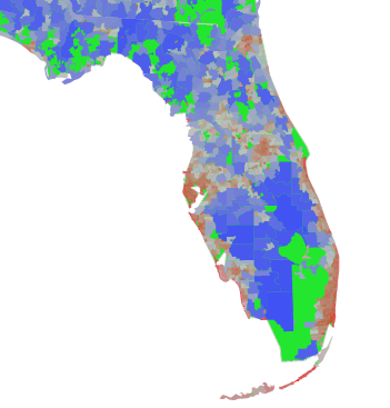

Zooming in to Florida you can see the smaller ZIP codes clustered around the coast. Setting the background states to fill with green, you can readily see the Everglades National Park and other areas not covered by ZIP codes.
Land Area rank by ZIP code for Florida
