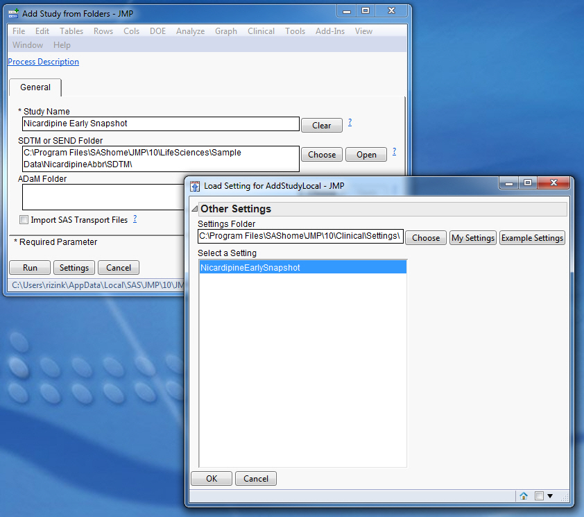

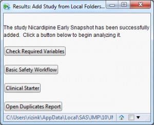

To add this early snapshot of Nicardipine to JMP Clinical, click the Settings button within the Add Study Local dialog window (Figure 1). From Example Settings, choose NicardipineEarlySnapshot and run the Add Study Local Analytical Process (AP). Once JMP Clinical has collected the appropriate metadata, the study will be added to the dropdown menu. Users are free to check if they have the needed variables to perform various analyses, run the Basic Safety Workflow or check for record duplication using Open Duplicates Report based on our discussion from last time (Figure 2). You’ll notice that this report describes the keys used for each data set and whether any duplications are present based on the keys.
Some duplications exist for several concomitant medications, though, upon inspection, these reflect uniquely-defined and entered medication records. Here, we would need to decide if we wish to go through the trouble of defining more complicated keys for the CM domain. We will still be able to save record level notes for these duplicates, though they will be associated with two records instead of one. Further, our ability to compare these duplicated records across new snapshots will be compromised. However, given that there aren’t too many of these records, it would not be overwhelming to review all of them at a later review cycle. The recommended strategy if an overwhelmingly large number of duplications are listed in this report is to:

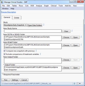

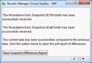

We can perform any number of analyses or add notes to records or subjects for the Nicardipine Early Snapshot study. To update the study to the complete Nicardipine data snapshot, go to the Manage Studies AP. Select the NicardipineEarlySnapshot example in a similar manner as above (Figure 3). Notice that the data directories are identical to the Nicardipine example. The option Compare new snapshot with previous performs comparisons between the two sets of data. Exclude comparisons of treatment variables will prevent any differences or notes based on unblinded treatment codes from entering the differences report or notes database. Once comparisons are performed, the user can select Open Snapshot Differences Report (Figure 4) to view changes to any variables from previously available records, duplications or records dropped from the current snapshot.

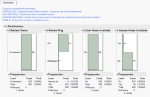

As a useful first step, the Review Status Distribution AP can be used to identify subjects that are newly available or with a modification to their data, subjects that have user- or system-defined notes available, or those that have been reviewed from the patient profiler (Figure 5). Filters for new or modified subjects can be created here so that analyses can be easily subset to the subjects of interest. Of course, notes can be added or reviewed at any time, and analyses can be easily subset to new records (described in this post).
