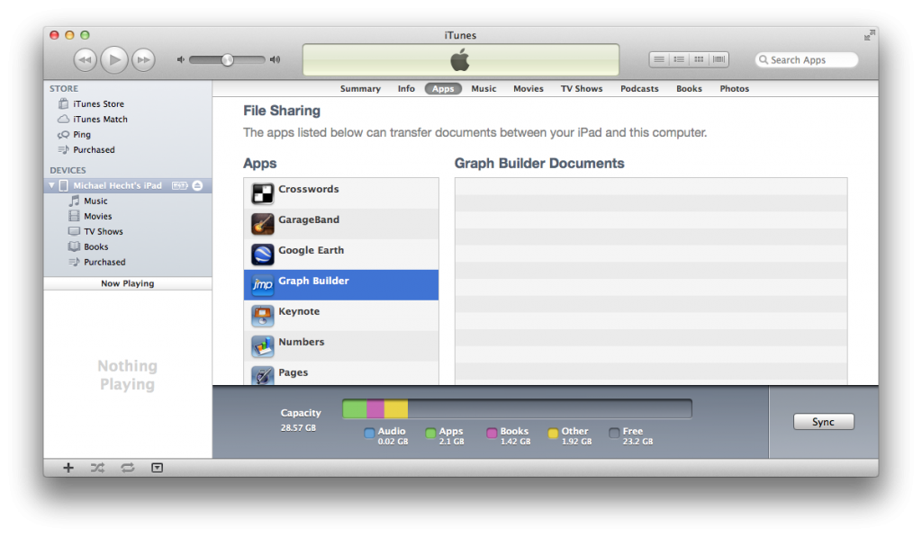

Scroll down a bit in this window to the File Sharing section. Like the screen says, you can see a list of your apps that support transferring documents between your computer and the iPad. I have not yet transferred any JMP data tables to my iPad; but if I want to do that, I simply drag the tables into the big empty list on the right. Then I click the “Sync” button, and the tables are copied to my iPad.

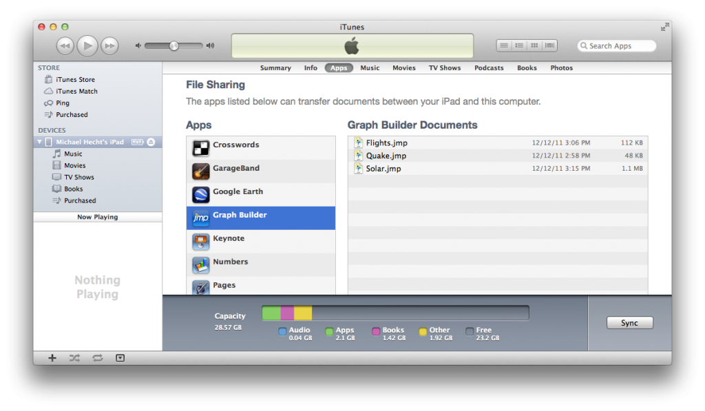

Here’s what iTunes looks like after I’ve synced Flights.jmp, Quake.jmp and Solar.jmp to my iPad. But where on my iPad did they go? When I open Graph Builder, I don’t see them. I have to first tap the + icon on the Graph Builder bar and then choose “Copy From iTunes.”

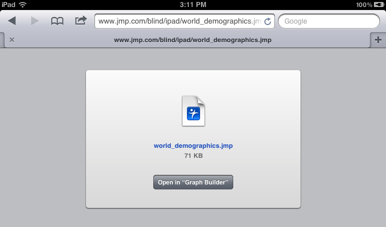

This method is not for everyone, but some people will find it incredibly useful. If you have a website that you can upload files to — a wiki, a blog, etc. — you can leave a JMP data table there for other users to download. On their iPads, these other users navigate to your website in Safari and then click on the link to download your data table. Safari asks them if they would like to open your data table in Graph Builder. Try it on your own iPad now by navigating to our JMP Graph Builder Samples page. Tap one of the blue “Download” buttons, and you’ll see a dialog like this.
