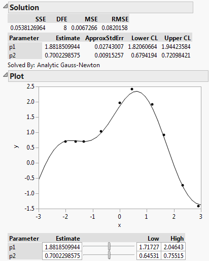

dt << Nonlinear( Y( :y ), X( :x ),
      Model( Parameter( {p1 1, p2 0.2},
            p1 *Cosine( p2 *:x ) + p2 *Sine( p1 *:x ) )),
      Finish, Confidence Limits );
That script produces the following interactive output.
Some of the other languages require a bit of extra work to get the confidence intervals, so it's nice to see it's just one option away in JMP.
