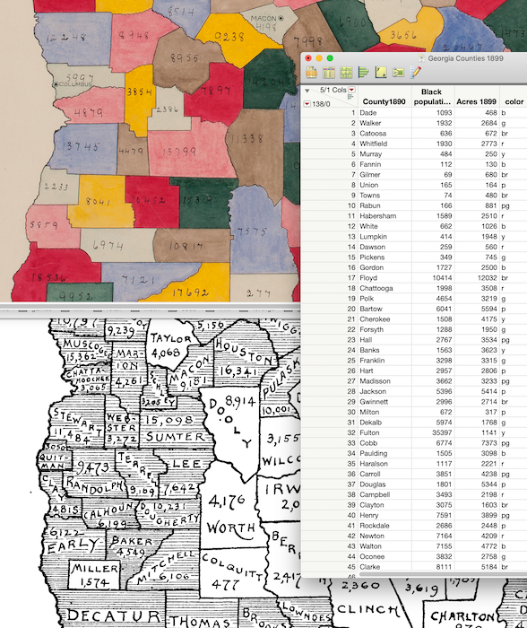

Not finding any corresponding data set, I started keying in the values from a high-resolution version of the map from the Library of Congress. I soon realized that the counties in the map were different from today’s Georgia counties. As part of my research, I found another map by Du Bois from around the same time that had the names of the counties. Using those together, I was able to create a data table of the information in the maps.
That was more work than I expected – Georgia has a lot of counties! And I still had one problem remaining: translating the old counties into the modern counties that JMP knows about. I spent a little while puzzling over ways to apply the old acreage numbers to the new counties. Some of the old counties were joined together, and others were split in two, and in trickier cases new counties had been carved out of multiple old counties. Not looking forward to diluting the data integrity by estimating values for the new counties based on the old counties, I started looking around for old map shapefiles and found the Atlas of Historical County Boundaries. Amazing -- just what I needed!
I downloaded the shapefiles for Georgia and imported the .DBF and .SHP files as JMP data tables. There were a few extra fields for each shape in the DBF file, including the dates of the county’s existence and its area. I filtered both tables down to only the counties existing in 1899 and saved the data tables to be used as custom map files. Then I linked my keyed-in data file directly to the map files with a Map Role column property.

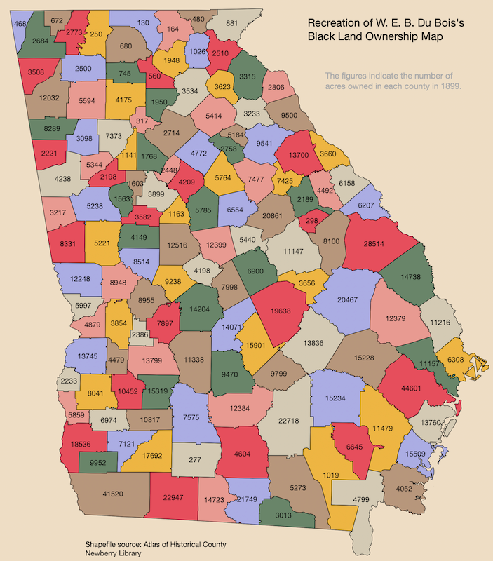

I had recorded each county’s color (one of seven) in my original data entry work and added a Value Color column property to mimic Du Bois’s original colors. Then it was just a matter of dragging that variable into Graph Builder’s color drop zone to color the counties. The map projection is a little different and I couldn’t capture the beauty of his hand-filled colors, but otherwise I was happy with the reproduction.

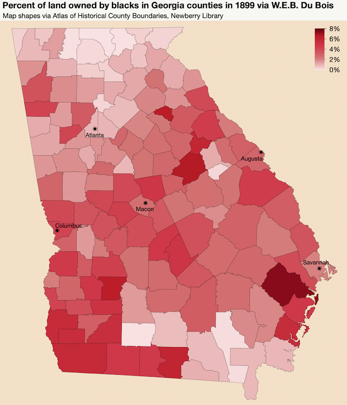

Finally, I was ready to augment the graph by showing the acreage with color. As a way of taking the varying county sizes into account, I colored the counties by the percentage of land owned by black people instead of the raw acreage value, which also provided a little context for the amounts.
Adding markers for the cities to the map required a little advanced work. I added rows to the table for the five cities in the original map along with their longitudes and latitudes, and then I layered a Points element over the Shapes element in Graph Builder and labeled the rows for the points. The final touch was to use the Unicode “fisheye” character, ◉, as the marker shape.
