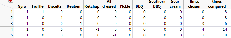

To try this, I needed to set up a new data table where each pair that was compared together in a choice set appears in a row, one with a value of 1, and the other a -1. Then I needed columns for the number of times each pair was compared, and the number of times the flavor with the value of 1 was chosen over that with a -1. Note that I didn’t need an additional row with the values of +/-1 reversed.
If you read the experimental setup, you may recall that we didn’t test the chips in pairs, but three at a time. To do this analysis, I split up each choice set into the three pairs that occur within it, since I can determine the winner and loser from each based on having the best and the worst from each choice set.
I found it easiest to set it up the same way that Clay did with the basketball data – set values of 1 for the first flavor, then put in values of -1 for one flavor at a time with the remaining flavors to the right, moving down the rows one at a time (for those of you who like to think of matrices, you get something that looks like a negative identity matrix). Just to give you an idea of what this looks like, the first few rows of my data table look like this:
chips_genreg1
You can take a look at the full data table on the File Exchange. I didn’t create a nice script to collect the data in the format I wanted – it was a matter of using table summaries and manually inputting the times chosen and compared for each pair.
