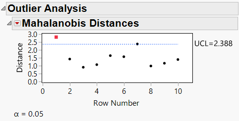

Yet when we performed a Mahalanobis distance calculation, the red point did not appear to be a “terrible” outlier:
Figure 2: Mahalanobis distance for 10 data point sample shown in Figure 1Figure 2: Mahalanobis distance for 10 data point sample shown in Figure 1
In Figure 2, the red point is above the line of significance, but not by much. This seems counterintuitive based on the Scatterplot Matrix of Figure 1 where the red point appears to be an obvious outlier.

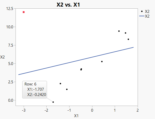

But remember, the Mahalanobis calculation involves measuring the distance from the whole when taking the covariance structure of the data into account. If we take the highlighted scatterplot from Figure 1 and fit a straight line to it, we get something like this (from Graph Builder):
Figure 3: Simple plot of X1 vs X2, including best-fit line (from ordinary least squares)Figure 3: Simple plot of X1 vs X2, including best-fit line (from ordinary least squares)
The straight-line fit is a visual representation of the covariance structure between these two variables (X1 and X2). Note that the red outlier point is a heavy influence on the position of the line; it pulls the line up toward it, making the distance from itself to the line smaller than it should have been.
In addition, the poorly fitting line also makes it appear that other data points are farther from the line than they might really be if the red point hadn’t influenced it so strongly. For example, data point 6 (labeled in Figure 3) appears to be far from the line and might be on the border of being an outlier if this particular best fit line was chosen.

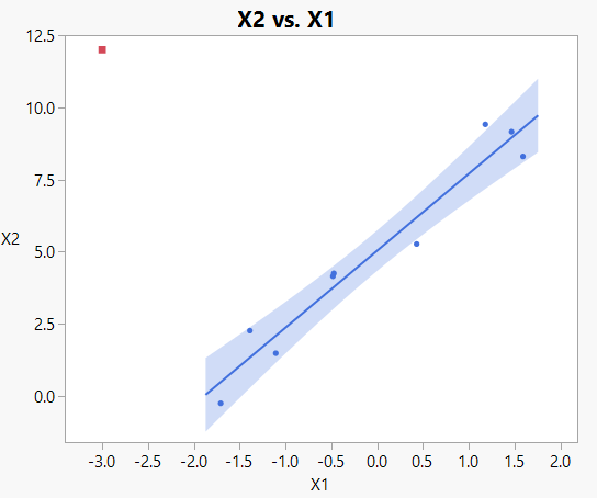

The jackknife technique is very simple, yet very powerful, relying on calculations using the “leave one out” technique. Conceptually, if we left the red outlier out of the line fit calculations, it would generate a scatterplot with best fit line that looks like this:
Figure 4: Simple plot of X1 vs X2, including best fit line based on all points EXCEPT for red outlierFigure 4: Simple plot of X1 vs X2, including best fit line based on all points EXCEPT for red outlier
Now it is clear that the red outlier is truly considered an outlier, warranting further investigation.

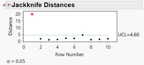

The jackknife plot then looks like this:
Figure 5: Jackknife distance plot for 10 point sampleFigure 5: Jackknife distance plot for 10 point sample
Now it is quite clear that the red point is an outlier.
