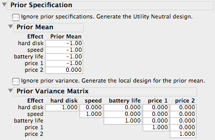

Next, we fill in the Prior Specification. Remember from my previous post that the optimal design depends on what the answer is, and we don’t know the answer. Actually, we already know a lot about the choices. We already know that people want large disks, higher speeds, longer battery life and lower price.
The experiment measures the relative strengths of these characteristics; it measures trade-offs, particularly the trade-off between price and features. The response is in the positive direction, utility. Notice that all the factor levels are ordered so that the least desirable levels are first and the most desirable levels are last.
Now we can tell the designer that we know the direction of these levels. We do this by entering a prior mean. We say that 80 Gig (GB) is worth 1 utility unit more than 40 Gig. We say that 2.0 GHz CPU is worth 1 utility unit more than 1.5 GHz, etc. Of course we don’t really know the magnitude of these, and the uncertainty of that is expressed in the Prior Variance Matrix, with 1s on the diagonals. The convention is that if the first level is less desirable, then you enter a negative value, as we do here. When there are three levels in increasing utility order, enter negative, then 0. Actually, it doesn’t matter whether we enter the levels in the right order for the parameterization as long as the ordering is consistent across levels.
Laptop priorsLaptop priors
This Prior Specification is important in experiments like this, where the factors all have known preference directions and the goal is to measure trade-offs. If we didn’t specify this, then we could easily get choice-set items where one choice included all of the better factor levels and the other choice included all of the worse factor levels; in such a case, the choice response would be trivially obvious, and the run would be wasted.

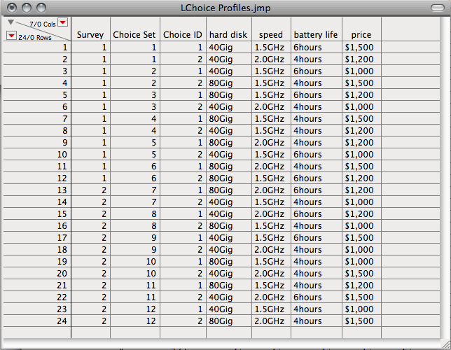

Now there are two levels of design data here. There are the profiles that go into making each choice set. There are two profiles per choice set times six choice sets per survey times two surveys, making a table of (2*6*2) 24 unique choice profiles.
laptop profile tablelaptop profile table
This structures the factor-level data so that you can prepare the raw material for the survey.

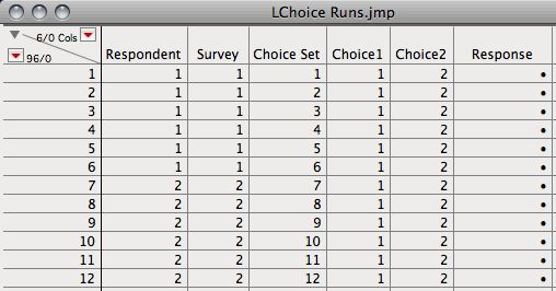

Then there is the subject-level data for the responses, showing which subjects get which survey and having a slot to enter the response for each choice trial. Here are the rows for the first two subjects. The first subject is taking Survey 1, and the second subject is taking Survey 2.
laptop responses tablelaptop responses table
The Choice1 and Choice2 values index the Choice ID value in the Profiles table that matches the Choice Set ID. For example, in row 10, Choice1 is Choice ID 1 for Choice Set 10 in Survey 2, which is Row 19 in the Profile table (80 Gig, 1.5 GHz, 4 hours, $1,000), where the other choice is the next profile in Row 20 (40 Gig, 2.0 GHz, 4 hours, $1,500).
