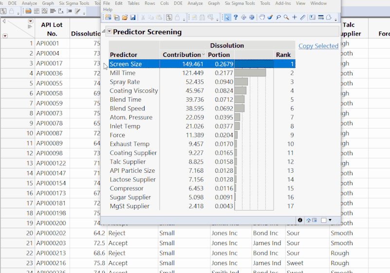

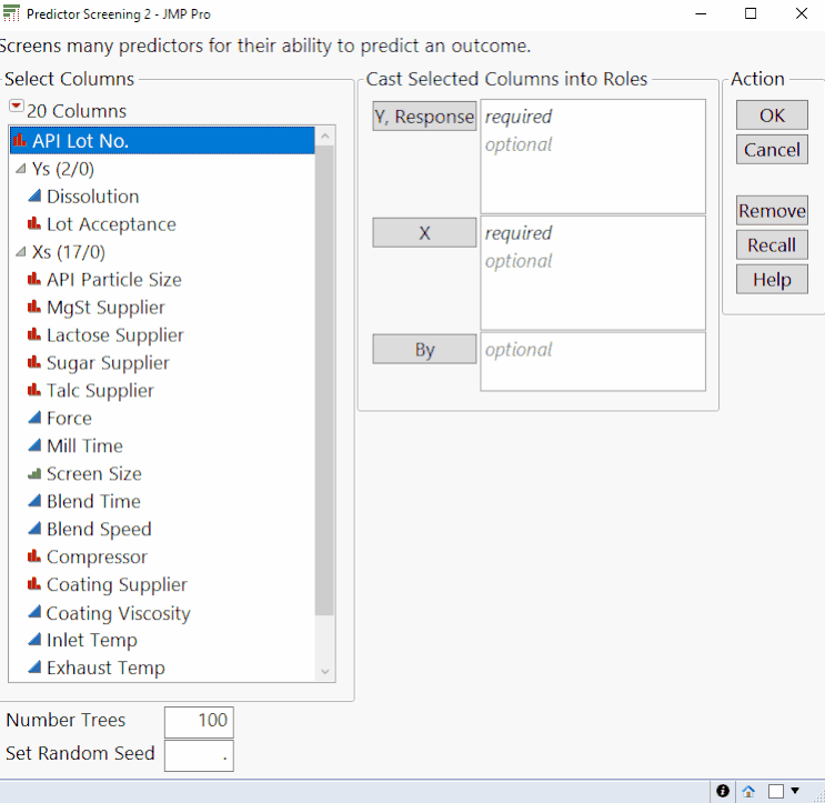

Go to the Screening menu under Analyze, and select Predictor Screening. A new window now appears. All you need to do here is two simple drag-and-drop clicks! One is for adding your desired output(s), and the other is for adding your inputs.
In the example below, after selecting Dissolution as my output of interest, I drop it in the box next to Y, Response. I then select all 17 inputs, and drop them in the box next to X.
The default setting is to build a bootstrap forest model using 100 decision trees, but the number of trees can always be modified at the bottom of the window.

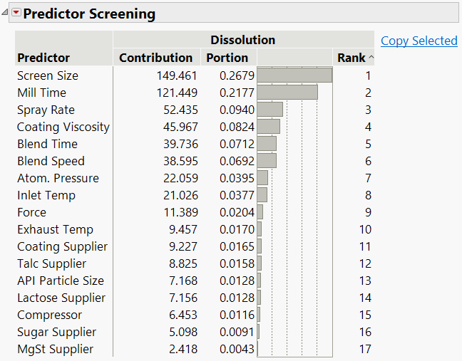

After clicking OK, the predictor screening report is created. Boom! Your predictors are ranked from highest to lowest contribution in the bootstrap forest model. Predictors with the highest contributions are likely to be important in predicting your response. The resulting table will also have a portion column showing the proportion of the variation in the response attributed to a predictor. The best part is that all of this was done in less than a minute!
In the example above, Screen Size, Mill Time, Spray Rate, Coating Viscosity, Blend Time, and Blend Speed are the top six most important variables, and the sum of their portion values is just over 80%.
The top predictors can then easily be copied and pasted into another analysis window for further study. All you need to do is highlight the predictors of interest and click on the Copy Selected link to the right of the table.
