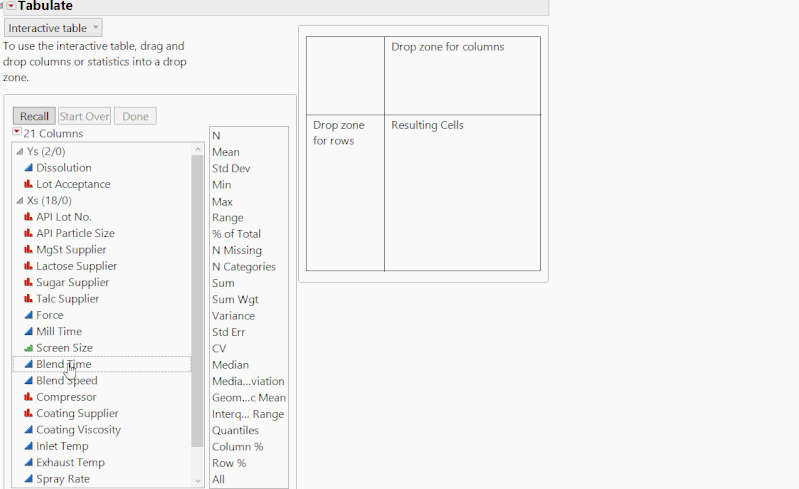

All you need to do is go to the Tabulate platform from the Analyze drop-down menu. When you do this, a new window appears. At the left of this window are all of your column names (containing all the rows of data associated with that column) and a comprehensive list of summary statistics. To the right of the summary statistics is an interactive table where you can drag and drop either your column names or desired summary statistics.

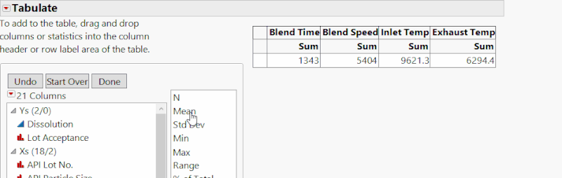

For your first drag-and-drop click, select your columns of interest and then drag and drop them to either the drop zone for rows or the drop zone for columns. The default summary statistic is Sum (adding all the values across all the rows within a given column). In the example below, after choosing Blend Time, Blend Speed, Inlet Temp, and Exhaust Temp as my variables of interest, I drop them in the drop zone for columns.

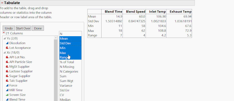

For your second drag-and-drop click, select your desired summary statistics, and then drag and drop them in the gray box next to Sum. In the example below, I am choosing everything from Mean to Range.
In the examples above, I obtained five summary statistics for four variables in matter of seconds! It could have easily been more variables or more statistics in the same amount of time!

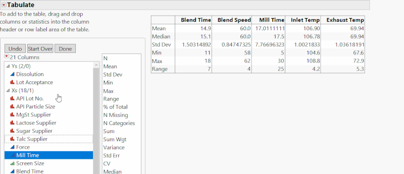

  1. After creating the table, what if I decide that I want more variables or more statistics? Not a problem! You can just select the statistic or variable and drag it above/below or to the right/left of other statistics/variables. In the example below, I add the median statistic and the Mill Time variable to the previous table.Tabulate step 3.gif
