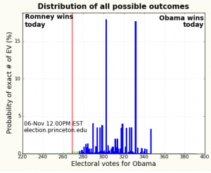

I was interested it Monte Carlo simulations of the election using the poll-averaged probabilities in each state. Both Silver and Sam Wang at Princeton University produced graphs of such simulations. Here is Wang's graph at the Princeton Election Consortium website.
A qualitatively similar plot appears in Silver's blog referenced above and shown below.

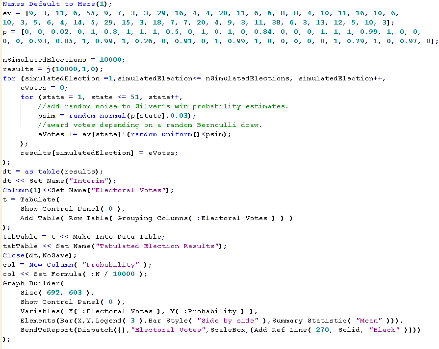

I wrote a script in JMP to reproduce this graph. An image of the script appears below.
The script generates the plot below using the Graph Builder in JMP.
Note that while the three graphs exhibit qualitative similarities, the y-axis values are different. This is due to different assumptions being made about how to model the uncertainty in the probability estimate for each state.
The actual electoral vote count for Obama was 332, which corresponds to the second highest line in my plot at a probability of 13-plus percent. The highest line (nearly 14 percent probability) at 303 electoral votes included all the same states except for Florida, which has 29 electoral votes. Note the line at 347. That would have been the result had my home state of North Carolina also voted for Obama.
The number of simulated results below the black vertical reference line at 270 is very small. This suggests that the election was not all that close and certainly not too close to call.
