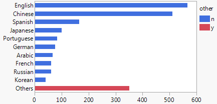

Making a bar chart in Graph Builder was quite straightforward, but there were three tweaks that are not so obvious. Can you spot them?
1) Showing millions of users instead of raw user counts on the axis. For that, I created a formula column that was just
2) Ordering the bars. For ordering, I used the existing rank column, though it would have been easy enough to add such a column. I dragged it into the Merge/Order hot-spot, which is just inside the axis. It’s highlighted in blue when dragging.
After that, I right-clicked to change ascending to descending to get Others at the bottom.
3) Graying the bar for "Others." In Graph Builder, the bar color can be determined by a data column, so I created a new column called "other" with values of "y" for the "Others" row and "n" for the others. Then I used that column in the Color role to get it a separate color for it.
I right-clicked on the legend to change red to gray, and I excluded the legend from the final picture (so the actual values didn't matter).
After some final adjustments for the axis text and sizing, I saved the image as an SVG file and verified it in a Web browser.
