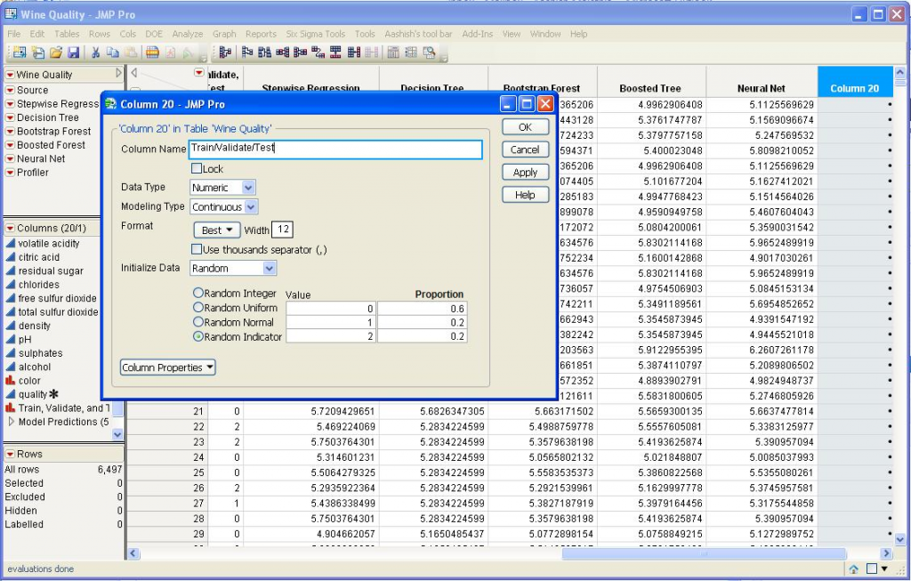

JMP Pro is a huge breakthrough in simplifying the process. The first enhancement introduced is a much easier way of generating a validation column. From JMP, choose Cols -> New Column, Initialize Data -> Random -> Random Indicator. Random Indicator column will default to values 0 (Training) , 1 (Validation) and 2 (Test). You can now choose what portion of the data you want to use for each step.
Validation Column Generation
