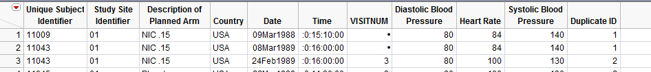

The Duplicate Records AP identifies sets of variables that may occur more than once. What does “record” mean? For our purposes, record will refer to a set of tests reported at the same visit and time (if applicable) number from the same domain. This will often encompass a single panel on a CRF page. For example, a set of vital sign measurements (stored in the SDTM VS domain) may be collected for a subject:
Visit
Systolic
Diastolic
Heart Rate
Visit 1
140 mmHg
80 mmHg
84 bpm
It would be extremely unusual to find the same exact set of measurements within the subject or across subjects within the same clinical site. Multiple hits between two subjects can possibly indicate that CRF pages were copied between these subjects. Even worse, a large number of multiple hits may identify a fictitious subject. Hits within a subject can identify “carried-forward” problems similar to those described above, or it may indicate visits that did not actually occur for the subject. Figure 3 identifies the triplicate above among two subjects within the same clinical site.
While unusual, it is possible for a record (i.e., a set of measurements) to occur between or within subjects. However, if this same record is repeated among multiple subjects within a clinical site, or repeated across multiple visits or time points, or there are a large number of tests that make up the record (say, a lab panel of a dozen or more tests), this would warrant additional investigation.
