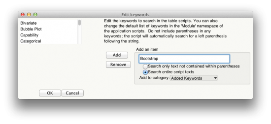

A neat feature for this add-in is its customizability – you can add your own JSL keywords to the tool to correspond to your own needs and interests. An example is shown below, where I want to quickly find example tables using the Bootstrap feature. The documentation is an excellent place to go for a detailed example, but in this case, I am looking for a canned example. Choose the Edit button to get to the Edit Keywords dialog shown below. Enter your item of interest and press Add. When you press OK, the directory of tables will be scanned again for your JSL keyword(s) and a new category will be added to the results.
In the image below, you can see that the Bootstrap keyword was added both to the left and right lists. There is one canned example of Bootstrap in the sample data, in the US Store.jmp table. Another use might be getting a list of all tables in your own folders of stored tables that use certain custom functions.
