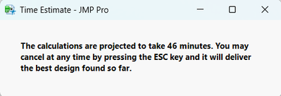

Note that one treatment of the full factorial design (uniform design with nine factors and 100 runs per factors) couldn’t be done due to high computation time (Figure 15):
Figure 15: JMP message displayed for the combination uniform design, comprised of nine factors and 100 runs per factor.
This design computation was aborted before completion for this configuration. Even if this experiment was missing in the full factorial design, the analysis could be conducted without any problems.
