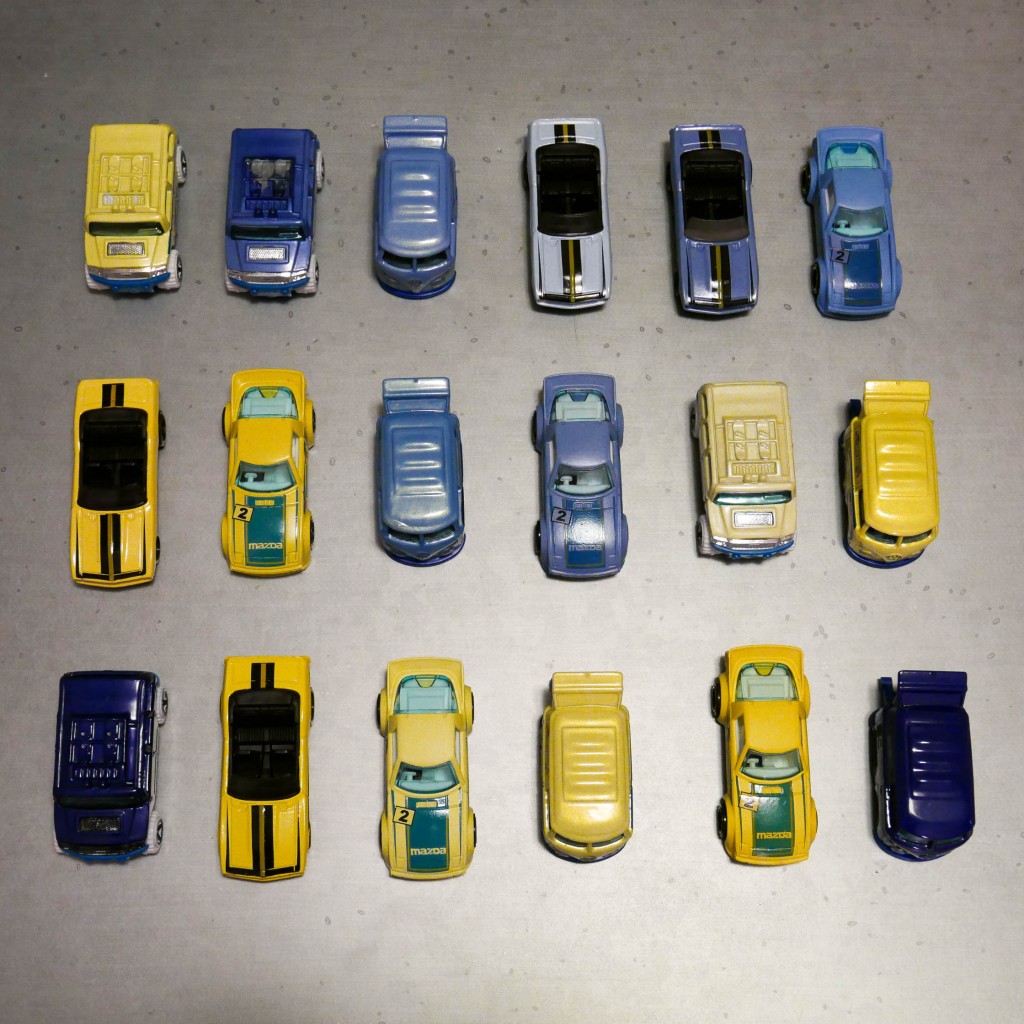

After dyeing the 16 cars in the experiment, there were noticeably better results compared to the first experiment (and noticeably worse when you consider the melting of the car…). Before I let the raters look at the cars, I picked out two of the cars that stood out to me and highlighted their rows in the data table to see if anything popped out at me. Sure enough, those two (different cars and colors) had two factor level combinations in common: additional heat and 50% vinegar. Alas, because of the constraints, there were only four runs that had additional heat (and two that had added heat and vinegar, which also happened to be the two I was interested in), which still wasn’t much extra information.
I had a couple of extra cars available, so I decided to do my own augmentation with two cars having additional heat. I dyed one car in blue with 50% vinegar, and one in yellow with no vinegar (both for 30 minutes to see if the color would stick).

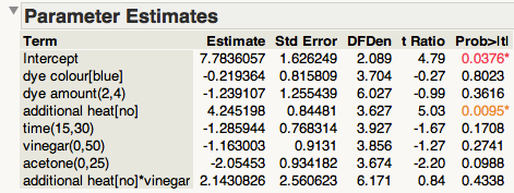

Because of the exclusions with the acetone, the acetone*vinegar interaction is not estimable with the main effects. Fitting the main effects model:
Not surprisingly from what I had observed, additional heat was the most important factor. Dye amount and acetone look potentially interesting, but I was also curious in the additional heat * vinegar interaction. Fitting that model:
Note that the additional heat*vinegar interaction is not significant, although the effect itself is large. Most of the main effects are relatively close, but you may notice that the effect of dye amount has dropped. Recall that additional heat*vinegar was not included in the original model. Even in picking the alias optimal design, the -.43 in the alias matrix for the dye amount with the additional heat * vinegar interaction is enough to make a difference with the size of the interaction.

In particular, the three highest rated cars were 50% vinegar with additional heat. You may notice there is one point that performed reasonably well with 25% vinegar – this car also had 25% acetone, and on closer inspection, the plastic was a bit affected. Recalling that additional heat meant no acetone, I don’t think I’ll be using acetone in the next experiment (my wife didn’t appreciate the acetone smell in the kitchen either, so it would’ve been a hard sell). So vinegar and heat will definitely be in the next experiment. While time and dye amount are not as significant, there may still be some value in carrying them through.
