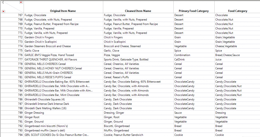

I cleaned up the food log data table that I had presented at Discovery Summit last fall using the Recode platform in an early adopter install of JMP 12. At the time, Recode lacked the new Save/Load Script options that I now rely on for all my data cleanup projects. Instead, I recoded my items and created a lookup table that listed the original and recoded names for each unique item that appeared in my food log. I updated this lookup table each time I added new items to my food log. A section of my lookup table is shown below.
Lookup table

To fill in the list of paired original and recoded names that fell between the beginning and ending sections, I created a new formula column in my lookup table containing quoted versions of the original item name and the recoded item name.
Recode Script Syntax
I copied and pasted the formula column into a script window, and then added the correct statements and variable names at the top and bottom of the script.
