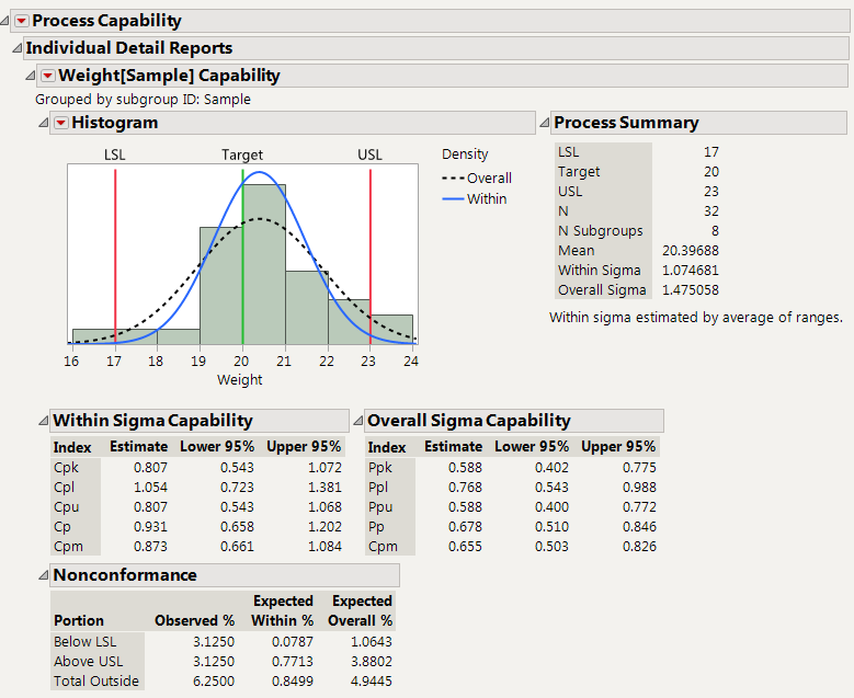

    5. The Process Capability platform is designed to help users analyze multiple processes at one time. However, because it is important to analyze process capability in conjunction with process control charts, we have also added the individual detail report that is given in the new Process Capability Platform to the Control Chart Builder platform. The figure below shows this individual detail report that is available in both the new Process Capability Platform and Control Chart Builder Platform. This example uses the coating.jmp sample data table and gives the process capability analysis for weight using the sample column as the subgrouping column.
      CoatingIndiv
      Individual Detail Report in the Process Capability Platform
