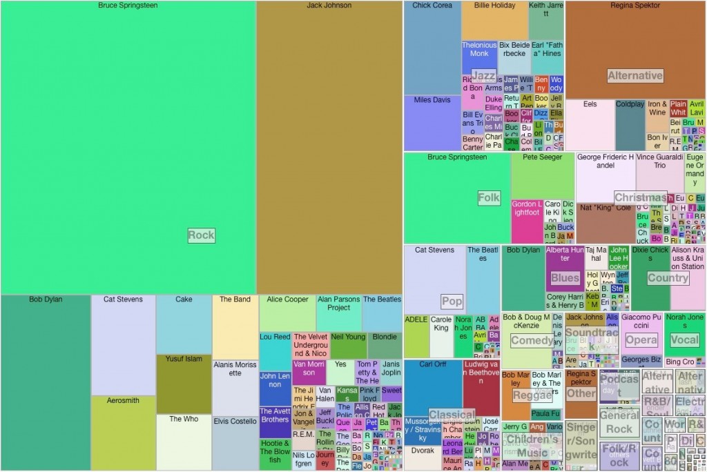

I’ll save the full analysis of the data for my last post, but I’ll give you a preview. Below is a Treemap showing my listening by genre and artist. I do love Bruce Springsteen and have “forced” my kids to listen to him a lot over the years, even taking them to many live concerts. I also love opera, jazz and blues. As you can see, I just love music.
Tree Map of Play Count by Genre and Artist using the JMP Tree Map platform.
Treemap of Play Count by Genre and Artist using the JMP Treemap platform.
