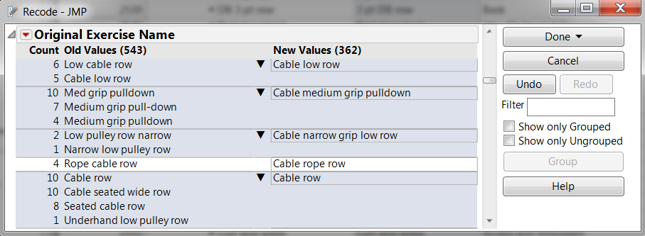

When I graphed my weight training data at the exercise level, I realized that I had referred to the same exercises by different names over the years. These naming inconsistencies were largely due to differences in exercise names used by various workout programs I had followed, but I also noted spelling mistakes and word order differences among the exercise named used in my data table. I needed to group duplicate names and choose a single representative value before I could efficiently summarize my data at the exercise level and compare exercise patterns over time.
Fortunately, the new grouping and filtering features of the JMP 12 Recode platform made my data cleanup process straightforward. Below is an example where I had used various different names for the same back exercises across workouts. I used control-click to select the various names used for different exercises and right-clicked to group them manually, then modified the group name. While consolidating exercise names, I modified many of their names to begin with type of equipment used (e.g., band, cable, DB for dumbbell, BB for barbell). This helped sort exercises using similar equipment together in graphs and tables.
Recode exercise name in JMP 12
