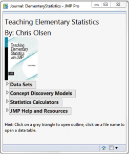

Start by creating a new journal (use File > New > Journal). Every resource you wish to include can be accessible via this journal, such data sets, calculators, scripts and important links.
To add files and subfolders, right-click and select "Append Item." You can see an example of a finished JMP Journal for a textbook below:

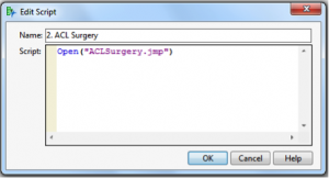

In order for these links to work for your students, you must change the file path. For each link, right-click on the link and select Edit > Set Script. Simply replace the script with…
Open("filename.jmp")
For example:
You can also change the text displayed for the link by editing the name.
