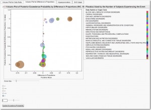

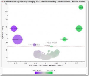

Figure 1 summarizes the adverse event analysis of Nicardipine versus Placebo using a Bayesian version of a volcano plot (Figure 2). In lieu of the –log10(p-value) for the y-axis, we use the posterior exceedence probability, which is initially defined as p[difference in proportions > 0|data] (or odds ratios could be analyzed instead). For each adverse event, this probability is calculated as the number of posterior samples where the difference in proportions (Nicardipine – Placebo) is > 0 divided by the total number of posterior samples (here: 10,000). This can be interpreted as the probability that Nicardipine has excess risk for an event compared to Placebo. The user is free to alter the definition of the posterior exceedence probability and redraw the volcano plot.
The x-axis is similar to the Frequentist volcano plot, except that we use the posterior mean of the difference in proportions (which is just the average of all posterior samples). Bubbles are sized so that the area of the bubble is proportional to the total number of subjects experiencing the event across both treatments combined. Color indicates the system organ class to which events belong. It is straightforward to observe that several vascular disorders, respiratory and psychiatric disorders show increased risk for Nicardipine.

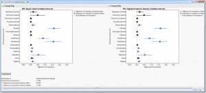

Figure 3 contains Forest Plots that summarize the equal-tailed and HPD posterior credible intervals for all events where p[difference in proportions > 0|data] > 0.80. Using the equal-tailed intervals, we can see there are several events that appear to have higher risk for Nicardipine: Isosthenuria, Phlebitis, Pleural effusion, Hypotension and Agitation. These events also stand out in Figure 2.
However, the Bayesian model highlights additional events: Atelectasis (collapse of part of the lung) , Delirium and Disorientation. Atelectasis was experienced by 86 (19.2%) and 63 (13.8%), Delirium by 6 (1.3%) and 0 and Disorientation by 8 (1.8%) and 3 (0.7%) subjects for Nicardipine and Placebo, respectively. The raw and FDR-adjusted p-values for Atelectasis were 0.0293 and 0.4100, Delirium were 0.0132 and 0.2876, and Disorientation were 0.1222 and 0.5416, respectively. Redefining the exceedence probability and examining events where p[difference in proportions < 0|data] > 0.80 shows an increased risk of Hypertension and Vasoconstriction for Placebo (which agrees with the analysis in Figure 2). However, Sinus Bradycardia shows no important difference between treatments. This is likely due to the fact that there are 12 other events in the Cardiac Disorders system organ class with no treatment effects. Ideally, the Bayesian analysis should assess the sensitivity of the results to different prior assumptions, but we have identified some additional adverse events between the treatments that require greater scrutiny.
