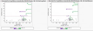

For each type of AE within the study database, the AE Time-to-Event analytical process compares treatments using the time to the first event for each subject. Figure 1 includes a summary of all AEs for the Nicardipine example using two popular statistical tests for Nicardipine, Log Rank and Wilcoxon. Similar to the incidence screen, you can quickly identify differences between the treatments (adjusted for multiplicity) and drill down to view individual Kaplan-Meier (KM) Curves for events of interest. For example, Figure 2 displays the KM curves for Isosthenuria. Not only does the Nicardipine treatment arm have more subjects with events, but these events also tend to occur earlier than for subjects on Placebo.
