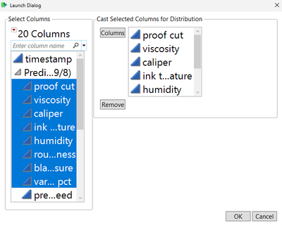

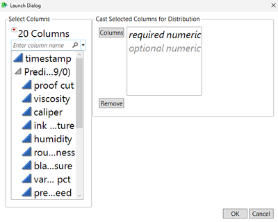

1) Launch the add-in, this will prompt a column dialog showing all numeric continuous columns
2) Select and add the variables you would like to test for distribution type and generate random columns from.

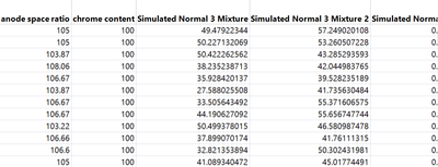

3) New random data columns will be created (entitled 'Simulated', with distribution type marked)
