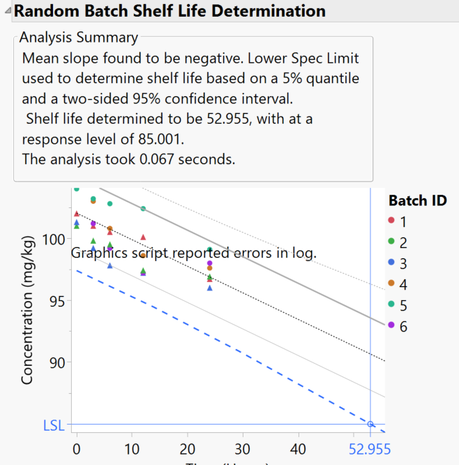

Hi Mike, thanks for the nice add-in. However, there's a line indicating that there are reported errors in my graphics scripts. Can you help me on this?Screenshot 2024-08-22 104712.png

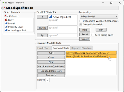

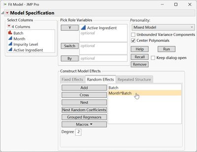

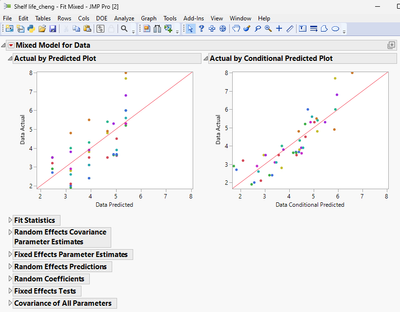

Since I felt that the variance components of some of the random effects terms were strange in some of the dataset tests, I looked at the settings for the mixed model launching platform.
The current random effects settings in this add-in are as follows, intended to assess different batches of drugs with different degradation intercepts and slopes.
This may have the same intent as the following settings, but the resulting variance components may not be the same, leading to different estimates of shelf life.
I wonder if there are any relevant notes or considerations in the literature you referenced as to which setting makes more sense?
Thanks again for the great sharing!
@Alex_Xu - since I'm not actually calculating the components, you might want to put that into tech support. The blog I wrote on how the add-in works and which parts I actually wrote is linked at the top of the page.

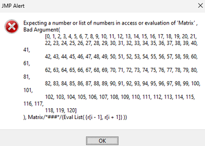

Thanks for the reminder.  This time, I use JMP Pro 18.  I see the JMP Alert below.
In my analysis, I did not see the session "Random Batch Shelf Life Determination" like you shown in your video.  Can you tell me how to turn on that session.

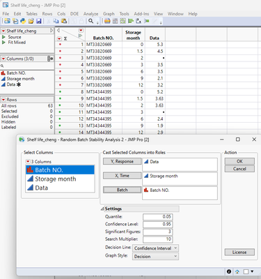

@stoneC - can you share a screenshot of what it looks like when you first start the add-in with the columns filled in (i.e. before you click OK to launch the analysis).  Also could you share a screenshot of what the columns and the first couple of rows of data look like?
M
stoneC
Hi Mike,
Thanks for the help.  Please see the screen shoots below.
Regards,
Stone
Okay - going to document this here.  It looks like the problem is that the search algorithm is failing due to some noise in the data set.  The good news is that this issue is corrected in JMP Pro 19.

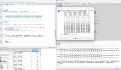

Hi Mike,
I have the same problem as StoneC with the addin and JMP19 Pro. Please see my print screen below.
It seems that the search algorithm cannot find r[ -1 ] (negative position of course does not exist).
You explained this is due to noise in the data, how could we resolve it, have you an idea please ?
