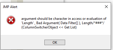

Great tool, but I am having issues getting it to run consistently, especially when I run a script then utilize your add in.  I seem to have more success with a fresh startup of JMP.  Making the graphs manually seems to work, but not the scriptd versions.  this is the error I get:
It might be the fact that I have a local data filter in the scripted ones?  But I swear it worked at some point!
Thanks
jthi
It seems like some of the objects won't allow you to send << Column Switcher to them unless you correctly define the initial choice (at least not in JMP17)

You might be able to workaround this by always including the current Y column as first in the column listing in add-in

Here is a script which might be able to tackle that issue in some cases
View more...
