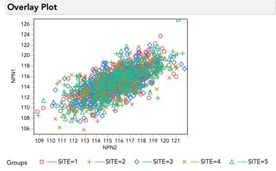

I think I understand now what you were describing, but let me reiterate it back to be sure. Overlay plot delivers a result like this:
Open( "$SAMPLE_DATA\Semiconductor Capability.jmp" );
Overlay Plot( X( :NPN2 ), Y( :NPN1 ), Grouping( :SITE ), Overlay Groups, :NPN1( Connect Color( 40 ), Overlay Marker( 8 ) ) );

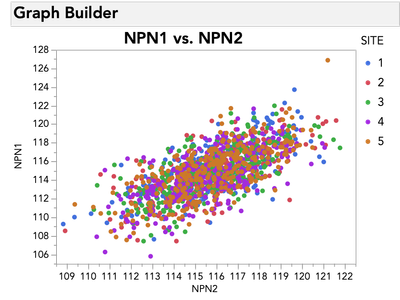

Which you prefer, because the markers for each group (site in your example) exist in layers stacked on top of each other. In other words, all Site 5 markers will be drawn on top of Site 4 markers, which will all be drawn on top of Site 3 markers, etc.  As you noticed, Graph Builder does the same:
Graph Builder( Show Control Panel( 0 ),
	Variables( X( :NPN2 ), Y( :NPN1 ), Overlay( :SITE ) ),
	Elements( Points( X, Y, Legend( 5 ) ) )

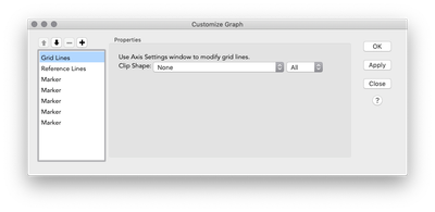

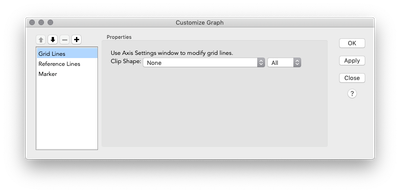

The reason for the difference in these platforms is that Overlay Plot and Graph Builder, being built purposely to deal with more than two variable, draw the markers in layers based on the overlying variable. You can see this for yourself if you right click > customize any of the plots. Graph Builder and Overlay Plot will look like this:cust - overlay.png
And Fit Y by X (bivariate) will look like this:cust-biv.png
Notice the five marker layers in Graph Builder / Overlap Plot (one for each site)? Those layers control the draw order, and thus the overlap order. Notice that there is only one marker layer for Fit Y by X, which in turn means that points, when drawn, can't honor layering with respect to another variable. When you create a Row Legend as you did in Fit Y by X (right click > row legend), JMP provides a legend that allows you to color or mark the points, but this does not fundamentally change the drawing behavior of the platform. After all, Fit Y by X is designed for one y, and one x, as the name implies, which means it is not built to draw the markers in layers, even if you have a legend to identify them. So I'm sorry to say, there is no quick fix (that I'm aware of) to force a Fit Y by X Bivariate plot to draw the points in layers like Graph Builder and Overlay Plot.

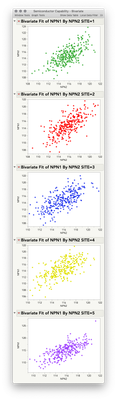

Another option is to take advantage of the By Variable when launching Fit Y by X, e.g:
Bivariate( Y( :NPN1 ), X( :NPN2 ), By( :SITE ) );
Admittedly, this isn't the same thing as this will give you separate plots, and separate models of fit by group. But, with large numbers of overlapping points and what sounds like a real need to see particular ones, perhaps this is an option?group.png

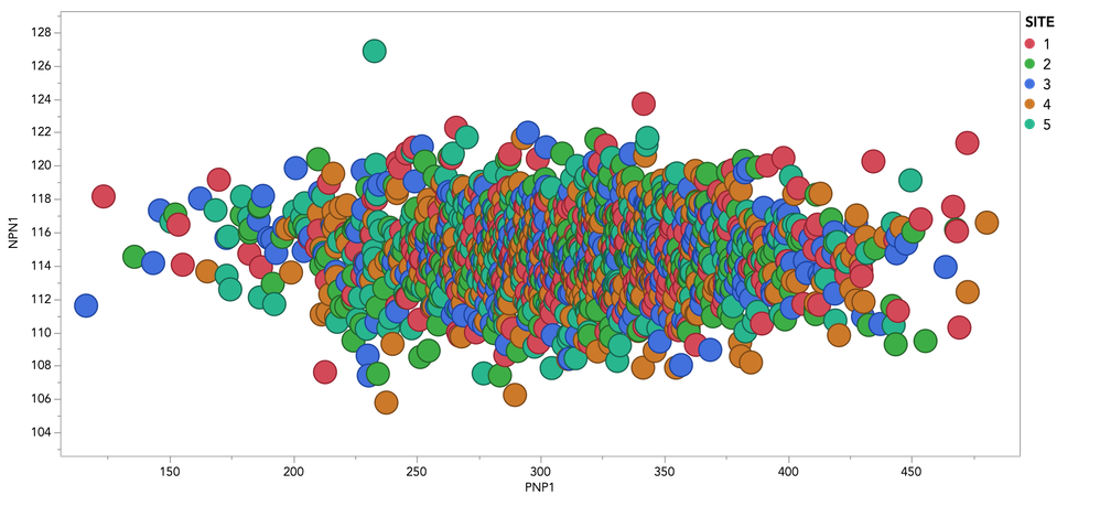

By the way, just to clarify a point made somewhere else (and because I think you might be interested) the layering of points in Fit Y by X Bivariate isn't simply random, but drawn left-to-right.  This is most easily seen if you outline the points (right click graph > marker drawing mode > outlined), and then make them larger (right click graph > marker size > other > 15+):
