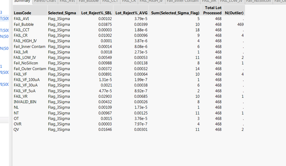

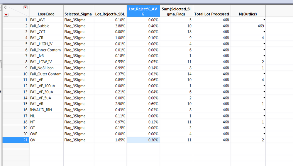

I cant seem to format the data from the data table when convert to table box , the data does not change in percent as in data table .
Wrong pic

When you specify:
lstValues = col << Get Values;
JMP is going to only retrieve the values in the column, not any information on the formatting.  To set the formatting, you need to pass the  "<< Set Format()" message to the Number Col Box().
Look in the Scripting Index for an example
     Help==>Scripting Index==>NumberColBox............Set Format
It gives a descripting and an example
