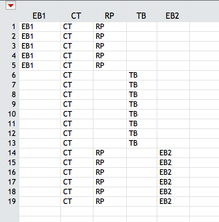

I would like to get a result as below without generating any additional row:
8372_Screen Shot 2015-03-15 at 10.46.04.png8372_Screen Shot 2015-03-15 at 10.46.04.png

As is often the case, there is more than one way to solve your data cleaning.  The option suggested will work well if you do not have too many codes as you will have to manually set up each column.  However, if I were to use formulas in manually set up columns I would use the formula:
If( Contains( :Packet, "CT" ),
  "CT",
  Empty()
This would give you the structure you are looking for.  If you have lots of codes then another way would be to use the categorical platform (Analyze>Consumer Research>Categorical).

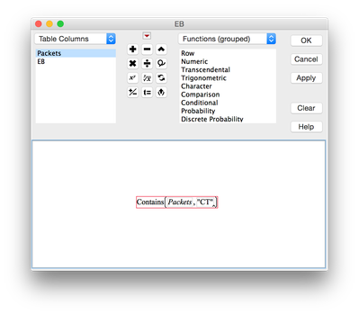

One way to do this is to create the different discount column as in your preferred output table and then give each of them a formula that tests if the column "packets" contains that code such as:
or in JMP script
Contains( Packets, "CT" );
This will give a 1 if test (does the Packet row contain "CT") and a 0 if it does not.
