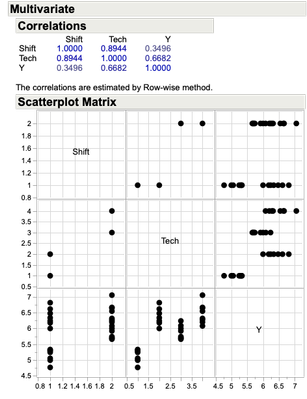

You can actually still do it by changing all of the variables to continuous just for this platform. I'm not interested in the statistics per se, but the plots. Agreed the categorical variables will look a bit strange, but obvious relationships can show up. For example, in the image I have attached I have categorical factors of Shift and Technician with an ordinal Y.  You can see, obviously, the correlation of shift and tech.
