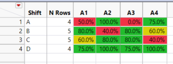

As we know Tabular report doesnt support color cells.
Therefore when its in a report there is no clear visualisation.
What is an alternative for this and how do we add the data table with color to the Window.
can I append the dt into a v list box so it can be but into my tab box report?

using the dt<<Get As Report worked

I expect this might be possible with some scripting. I would suggest using a chart instead. You could probably recreate this as a heatmap in Graph Builder (you might need to stack the data). Or there might be a better visual that more clearly highlights the important variations in your data.
