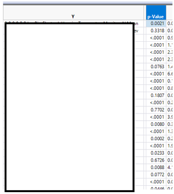

//Select the rows w/ low pVal, create a String value of all the Column Names, by selected row
pVals = Loc(dt1:"p-Value"n << get as matrix > 0.05);

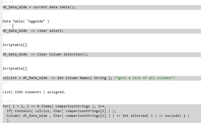

dt_Data_Wide << clear select;
dt_Data_Wide << Clear Column Selection();
colList = dt_Data_Wide << Get Column Names( String ); /*gets a list of all columns*/
For( i = 1, i <= N Items( comparisonStrings ), i++,
  If( Contains( colList, Char( comparisonStrings[i] ) ),
  Column( dt_Data_Wide , Char( comparisonStrings[i] ) ) << Set Selected( 1 ) << exclude( 1 )

It generates and sets the "ComparisonStrings" list
it clears selection of source table.
it generates the list of column names
but the looping to select and exclude seems to not do anything.

Your JSL is not doing anything that will change the data table you reference as "dt1";  If you want to eliminate the rows where the p-values are above .05, it would be a simple matter to add
dt1 << select rows(pVals);
dt1 << delete rows;
after your "Show( comparisonStrings );"
