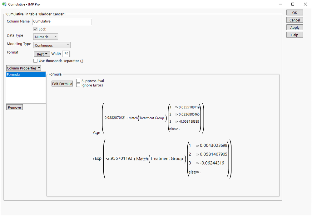

fit = Report(ra)[Outline Box("Fitted Recurrence Model")] << Get Scriptable Object;
intensity_col = fit << Save Intensity Formula;
cumul_col = fit << Save Cumulative Formula;

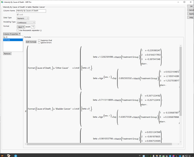

fit = Report(ra[1])[Outline Box("Fitted Recurrence Model")] << Get Scriptable Object;
fit << Broadcast(Save Intensity Formula);
fit << Broadcast(Save Cumulative Formula);
