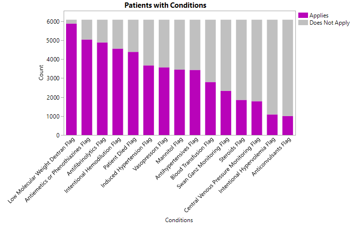

I have a data set of patients of which I have created a composite index of critical illness. This composite includes patients who died, who had ventilator requirement, who had septic shock , required dialysis et cetera (about total 16 categories all nominal yes/no).
Reviewer want to know how much of these categories contributed to the composite. There are a total 600 patients who met the criteria of critical illness based on my definition.
I can provide information like the number of patients who died (n=xx), ventilator (n=yy).. All of them would be in the composite.
The sum of all these patients would be more than 600 because all of them are overlapping with the other.
Is there a way to solve this and maybe create a graph or diagram showing the overlap . I'm thinking of the bubble plot but there might be another way of doing this.
I'm not sure I fully understand your question so I am starting really simple, could you show number of unique patients with each condition? In this example every patient was tested for every condition so the total is the same, thus I would remove the 'does not apply' bars.
I would think the most immediate measure would be the total number of the 16 indicators that each patient had. To investigate the contribution of each indicator to the composite, Principal Component Analysis comes to mind (although there may be a better method with nominal variables, such as Multiple Correspondence Analysis).
I used predictor screening platform in JMP. With Composite index yes/no as Y variable and added all the variables as X.
It gave me ranking of all the variables as they contributed to the index along with their percentage contribution. This will work for my purpose, not 100% sure it is the right way though as the variables are components of the composite
