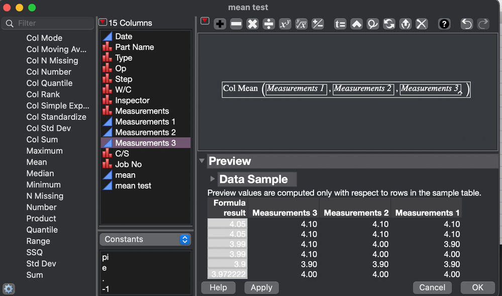

multiple column mean
See attached, I tried to add a new column for mean from 3 other columns by "col mean( col1, col2, col3)". But the mean seems a little bit off, and I used "(col1+col2+col3)/3" to verify, and it gives me the correct result. What is the possible cause of this? Screen Shot 2025-07-08 at 14.57.44.png

You don't want the Col Mean() function, you just want the Mean() function
Jim
Re: multiple column mean
Expanding on @txnelson's suggestion, the Col Mean() function uses the additional arguments after the first to group the data. This behavior is very convenient, but, as he said, not what you want this time.
