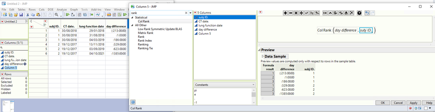

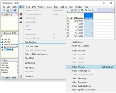

Hi @jsolo01 ,

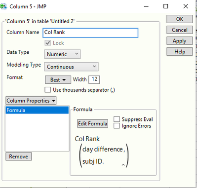

How about adding a new formula column "Col Rank" to rank the day difference according to subj ID.?
Then, you can select row "Col Rank" not equal to 0 & delete the rows.

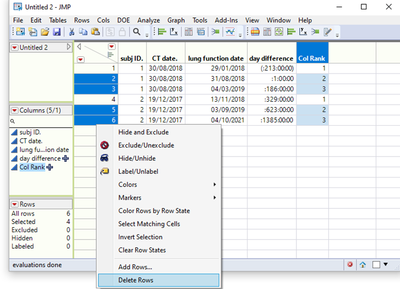

For;
subj ID 1, the min day difference is the 2nd row.
subj ID 2, the min day difference is the 4th row
1) Create new formula column: Col Rank

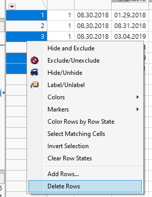

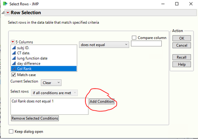

2) Go to Rows > Row Selection > Select Where
3) Define the condition: Col Ran does not equal 1 > click "Add Condition"
4) Right click the selected rows > Delete Rows

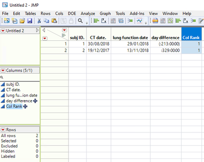

5) Final result as below
Hope it helps.

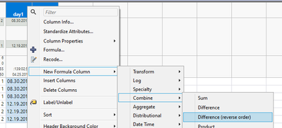

Just to extend a little on @WebDesignesCrow interactive solution:
If you don't already have the difference column, you can create it interactively (select both of your dates, right click on the column header and find Difference (reverse order). This will create a new column where the differences are in seconds. If you want to see them in yours/days you can double click on the created column and modify it as needed (such as add division by In Days(1)) but seconds work for this case

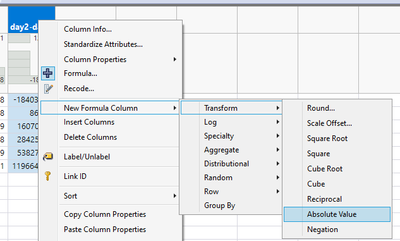

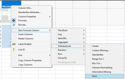

Then right click on this new column's header and make absolute value column out of it

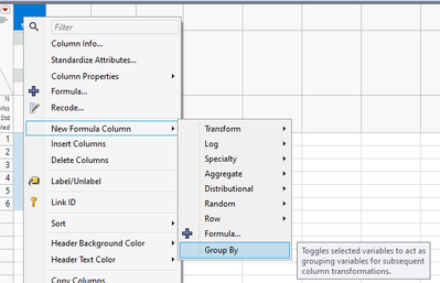

After you have that column, right click on the subjectid column and make it grouping column
next you can right click on the date difference column and create rank formula (note the grouping)

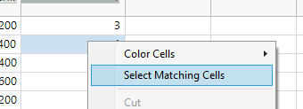

from the final column, right click on one of the "ones", select matching cells

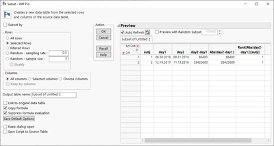

From here you can either create subset using selected rows
