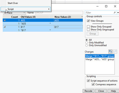

You can use Recode to do replace in your jmp table. Before you submit it you can then grab the script to use in the future.
dt = Current Data Table();
dt << Begin Data Update;
dt << Recode Column(
	dt:GROUP,
	{Map Value( _rcOrig, {"\!"A05", "A05", "\!"B17", "B17"}, Unmatched( _rcNow ) )},
	Target Column( :GROUP )
dt << End Data Update;
