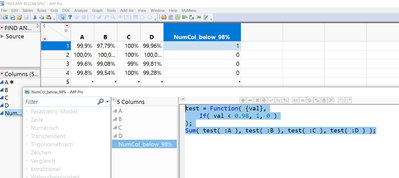

If I have 4 columns in my table and I need to find out per row how many columns fall below 98% how can I write a simple formula to do this.

Probably this formula could do:
test = Function( {val},
	If( val < 0.98, 1, 0 )
Sum( test( :A ), test( :B ), test( :C ), test( :D ) );

fionaweston
Level III
Re: how to count the number of columns in each row of data that fall below a certain value
This is just a short version. The real table could have 100+ columns.

fionaweston
Level III
Thanks Georg, that works!
