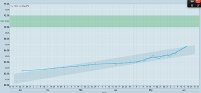

Hi all,
I have an ongoint set of data where the x axis is date and y axis is the CRM index. I would like to calculate when the line will hit the lower and upper "green zone". I can do it by formulating through fit y by x and create a prediction formula column and enter the date manually to next empty data row and try and try but I guess there is a better way of doing it. This would also be extremely helpful for calculation the Break-even point during the income statement. Many thanks in advance

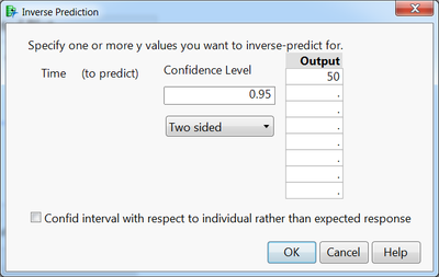

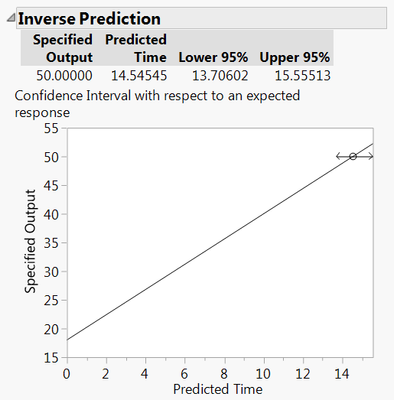

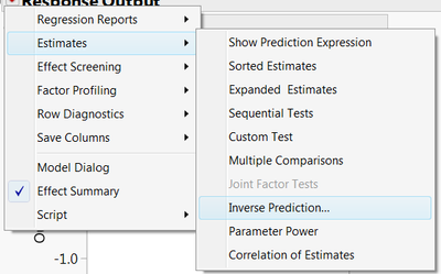

Fit your model using Fit Model. It can still be a simple straight line model, if you wish.
Then from the Response Output red triangle, choose Estimates > Inverse Prediction.
In the resulting dialog you can specify a confidence level to use because JMP will give you a confidence interval for the time that you will achieve your target.
In the Output window you put in your target value(s) (yes, you can specify more than one target). Clicking OK will give you the estimated time, confidence interval for that time, and a picture. Note that this gives the same result as the previous reply.

As with most things in JMP, there is usually another way, so here is another approach that you may wish to try. I will use the same data table that was in the previous post.
