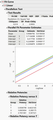

I fitted the parallel line model LogY=Sample+Log_Dose in fit curve.
The parallelism test and model parameters are fine. They are exactly same as what I got in R or PLA software.  But the relative potencies are totally different. Any place to find the technical details about its calculation? Thank you!

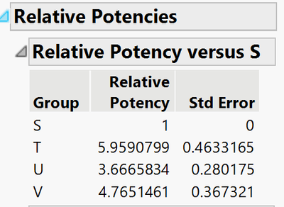

I used the example from PLA. The RP from R is 2.170981, which is the same as what I got from PLA software. But JMP's result is 5.9..

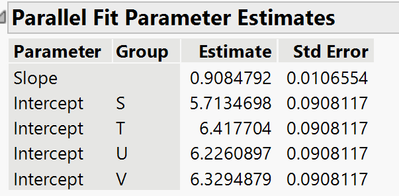

The estimated parameters are the same, so I think both are using the same model, just the RP from JMP is too large.

In JMP, I fitted the model in specialized modeling-> fit curve, polynomials->Fit linear, and test parallelism
