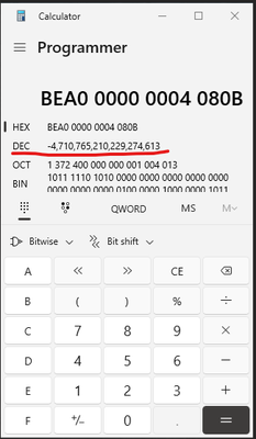

I have hex that is bea000000004080bh, I tried hextonumber("bea000000004080bh"), but it is not working. Can someone help me?

sorry, forgot to remove the h at the end. the output raw always have h at the end to indicate hex value which we need to exclude before we do hextonumber.
Now the issue is it doesnt match to the number as what we expected.
JMP converted it as -4.768372e-7
expected is -4710765210229274613
What I m missing?

sounds like there is improvement needed for the hextonumber() why cant it do the same like the calculator do (see picture in very first post)?
breaking down upper and lower 32 is not efficient when dealing with millions of data points. I have to process hundred of files that each contains more than 40M rows of hex value. doing the breaking down 32 will consume too much time.
