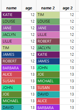

In Big Class, students have to write a letter to another student with the same age (student A writing to student A is OK).
Which Colum Formula can I use to add name_2?
The formula should be fast even with mio of rows.

I was stuck with col shuffle():
how can I convert the grouped index to a row index?
Ah, sure, use the grouped index as input for col at(idx, byGroup) -  perfect match!
Nice example for the new functionality.
