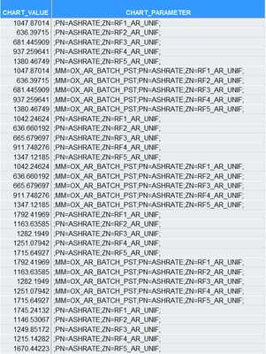

Hi All,
I am trying to sort my Data Table, it hase duplicate values:
As you see, I have same value for different name in CHART_PARAMETER, my interest is to take only rows that have one type of CHART_PARAMETER per each value. I tryed Filter Data but it opens JMP window with options to choose, I am trying to do all calculations so user wont see them and create a new Data Table with selected rows and do furthe manipulation with this Data.
Thanks.

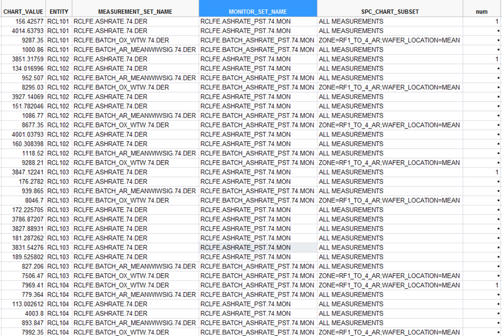

RosDima
Level II
Re: delete duplicate
Jim hi,
I tryed your script
Please see:
Table after code run.
Num didnt get proper numbers.

RosDima
Level II
Hi,
I still have only one value "1" for each ENTITY.
MP = AR << Sort(
by(ENTITY,LOT_DATA_COLLECT_DATE),Order(Ascending,Descending)
//MP:LOT_DATA_COLLECT_DATE << Format("m/d/y")<<Data Type("Character")<<Modeling Type("Nominal") ;
MP << New Column("num",
Character,
Formula(
	If( Lag(:ENTITY) != :ENTITY,
			num = 1,
			num = num + 1
	num ;
Can I use any other way? What can I do wrong? Date should be in specific format?
Lag function compare EVENT for EVENT from previous row, how does it now that value to compare is the Date column?
Thanks.
