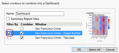

I think the drill-down capability that you want is referred to as a selection filter in JMP.  If you are using Combine Windows to create the Dashboard, there is a toggle button to filter by one of the reports.  Within the Dashboard Builder, there is a predefined template for creating a selection filter, or can you work with any initial layout and then right-click on a report to designate it as a selection filter.

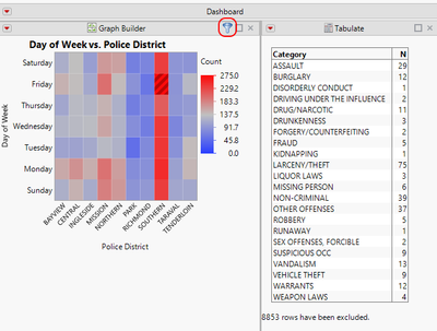

In the resulting Dashboard, a funnel icon indicates that the selection in the Graph Builder report will filter the data that is seen in the Tabulate:
